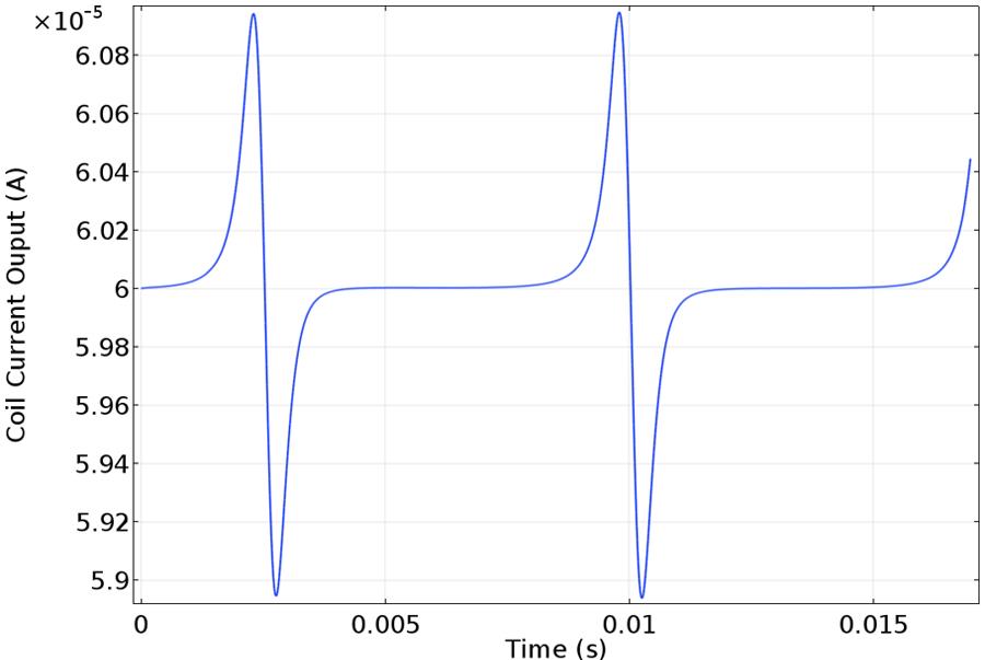

I have placed a moving aluminium conductor in a constant magentic field produced by a coil excied with constant voltage. I am unable to get any induced currents in the conductor. I am using magnetic fields physics and continuity is employed. displacement current density are ignored as i am using magnetic fields physics. And air medium is provided.

Thank you for the reply This is my comsol file. I have set a rotating motion to the aluminum blades and the coil is excited to produce a constant magnetic field.

this is better set up in a Rotating Machinery Magnetic (rmm) approach. Refer to the application library model in AC/DC Module > Motors and Actuators > generator 2D.

I have now used rotating machinery, Everything looks fine but my coil output current for simulatio is different than the required output as in attached image below.
